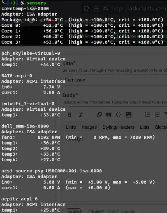

I'm facing a problem with my Dell Latitude 7490 - the fan is periodic running at maximum power for 15-20 minutes but nothing is hot. The laptop itself is not dirty inside. Here are the temperature sensor readings:
https://i.sstatic.net/A2HIRk68.png
