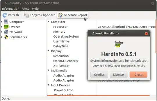

I provide technical support for several high schools in Spain and I have been building up a inventory of the schools machines. On the windows only computers I normally run PC Wizard to quickly get a good overview of the machines hardware, software and network settings. Is there an equivalent tool preferable with a GUI and an export option to html or pdf in Ubuntu.
I have tried a few options such as: Gnomes gconf-editor hardinfo (GUI) lshw (CLI)
I'm just looking for an all in one application that builds a detailed profile of the installed software, hardware and network setting of a particular machine.
I have found Sysinfo which is quite good, it displays the most important hardware info and allows you to save it to a text file with a neat GUI. I'm still looking for a more complete solution but it's a good start.

I had a look at the link mentioned by izx and tried all the options suggested and the one that meets the needs of the question is System Profiler and Benchmark
https://apps.ubuntu.com/cat/applications/hardinfo/
It gives a huge amount of information for easily adding equipment to an inventory and more importantly it has the option to save it in HTML format.
