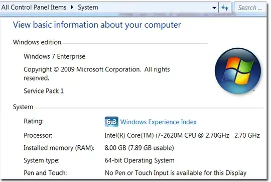

I am new to Ubuntu. In Windows, if I want to know my system properties/configuration, I can see it by going to Control Panel and clicking on the System icon. I can also get a detailed list of the hardware detected/installed by going to the Device Manager.
What are the equivalents of these features in Ubuntu, where a user can see his or her system properties and hardware configuration, like RAM, CPU/processor, hard disk capacity, etc.?
Example of Windows System Properties:

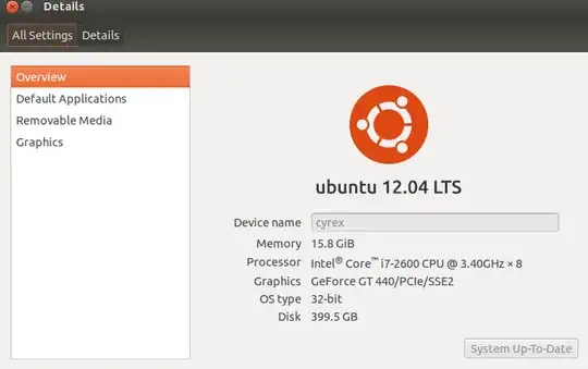

For Basic Information
Go to Settings, and under System, click on Details for basic information:

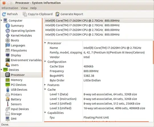

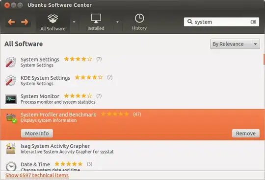

  • Search for "system" in Software Center, and install System Profiler and Benchmark:

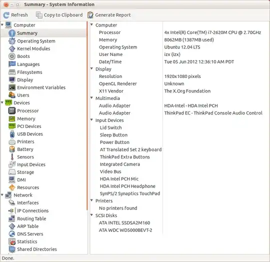

  • Then run it from the Launcher (type "system" if it isn't there already), and you will see a detailed list of hardware that you can expand further by category:
  • This tool also allows you to run benchmarks to compare how your system performs relative to other common computers.
  • Scroll down for examples of CPU and RAM information.

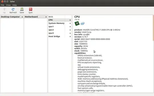

list all hardware
sudo lshw

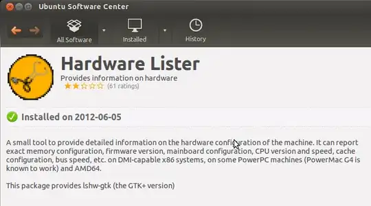

1)Hardware lister
Whenever you want to run it type sudo lshw-gtk in the terminal
Download it here

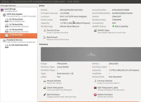

DISK UTILITY
Shows information about all type of storage devices, including but not limited to HDD, SDD, Flash Drives, External (Connected) USB Drives, etc..
To use it just open DASH (By pressing the SUPER key) and type disk. You will then see the option "Disk Utility".

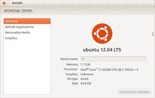

Ubuntu Detail Information
Type in dash detail and you will see a cog icon with the name "Details". It will show you basic information on your machine:
I should mention that if you are using an Nvidia card, you need to update Ubuntu 12.04 with the latest upgrades in order to see the Video card name.

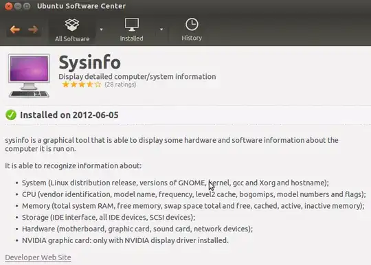

SYSINFO
Very nice program to see information about your computer.
It can be installed via the Software Center by looking for "Sysinfo" or "Hardware" or clicking here Install sysinfo
HARDWARE LISTER
Very nice program based on LSHW to show you in a graphical way all the hardware. As the previous one I mentioned, it can also be installed from the Software Center by looking for "Hardware" or clicking here Install sysinfo

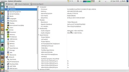

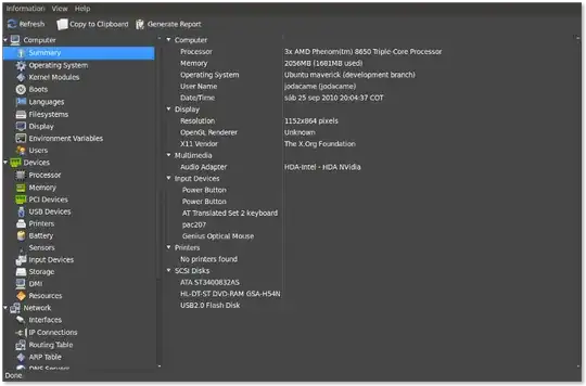

Try using hardinfo (System information and benchmarking tool)
Install via the terminal with:
sudo apt-get install hardinfo
Or use the Software Center:
Install via the software center
Invoke with the Dash and click on the summary tabhardinfo

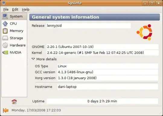

sudo apt-get install sysinfo
Then launch it!
