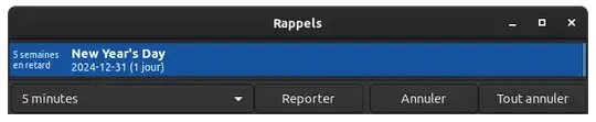

Update: The GUI list popped up today because I had a new reminder. It seems to be running from /usr/libexec/evolution-data-server/evolution-alarm-notify, however, that doesn't solve the problem because programs in /usr/libexec aren't meant to be run by the end user. How do I get this program to launch myself? As a workaround, I guess I could set up a new reminder, but that would take time to sync and launch.
(My system's in French. Translation: «Rappels» = "Reminders"; «5 semaines en retard» = "5 weeks overdue"; «1 jour» = "1 day"; «Reporter / Annuler / Tout annuler» = "Postpone / Cancel / Cancel all".)
