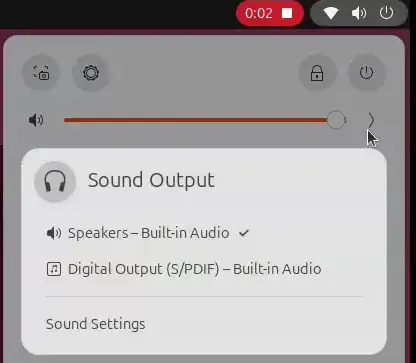

Again, the HDMI output disappeared. Here's a screengrab.

Becca
  • 133
I had exactly the same problem.
Fixed it with:
$ sudo vim /etc/default/grub
GRUB_CMDLINE_LINUX="intel_iommu=igfx_off"
$ sudo update-grub
https://www.kernel.org/doc/Documentation/Intel-IOMMU.txt
Hope it helps!
