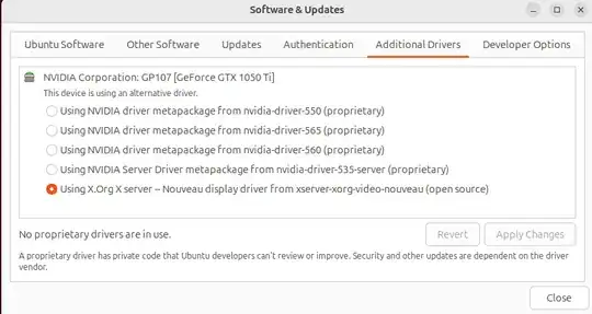

Software and Update result in the Nouveau display driver that is not installed and the 500 series drivers that break the resolution on the DVI port.
Software and Updates Screen
How can I get full resolution on the DVI port as well as getting output on the HDMI port and the DP (Display Port)?
