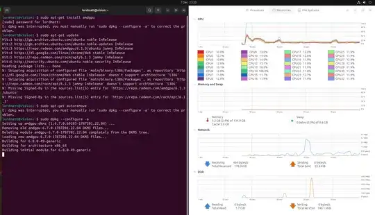

amdgpu
I tried to switch to amdgpu as ~I suspected that might be the problem. Oh, boy. The process hung; I watch Netflix; I go to bed; I get up and nothing has changed. It would get stuck setting up with the kernel. Most of my updates were me clawing back from that.
here is a screeny of that last build step just going hell-for-leather and getting nowhere.

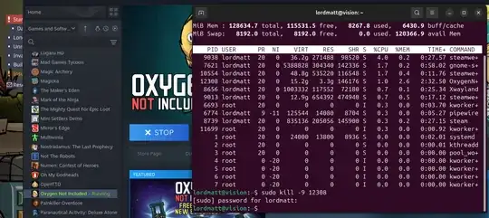

sudo kill and sudo killall
I threw both of them at the zombies and they just ignored me. System Monitor also zombied during these times. It had "technically" started but there was no GUI element. One time, it was running and I tried to go from the graphs to the process list. It was not happening. System Monitor has stopped responding. Click the option to end it. Get the message again like I had not done anything.
As I say, unkillable zombies. I've never seen anything quite like it.
Here's a capture of process 12388 refusing to be killed. The "Stop" button on Steam had a similar failure to make anything happen. I rebooted.
