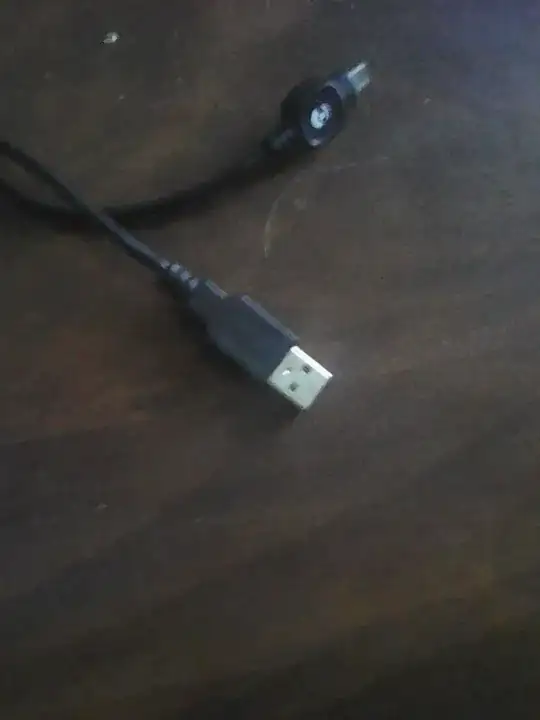

On my Windows 11 PC I installed Ubuntu 24.04. I have an old-fashioned cell phone (no internet connection), with an USB cable for connection to computers :
When I'm in the Windows 11 OS and I connect the phone through the cable, the connection is correctly and immediately detected :
When I'm on the Ubuntu OS however, the phone is nearly not detected at all, not even in the Disks application (even though my phone screen says "USB Connected" when I plug in the cable), so I cannot even format it. I say "nearly" because the lsusb command detects it :
