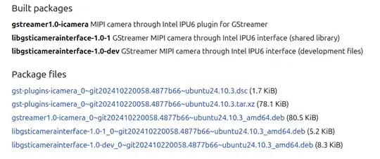

but I can see the package details for each one of them. For example the gst-plugins-icamera package has this contents:
I can install the .deb packages listed each of them, with the exception of libipu6 which is a transitional package, so I don't believe it's a problem.

Okay so the .dsc (from what I can find online) is literally just a text file, probably documentation for the .tar.gz. Now that tar is going to be needed to be extracted, and possibly have to figure out how to install what ever it brings. Ubuntu and .debs aren't like .exe on Windows and they won't tell apt to do anything with the other files in the same folder. Also if you don't append "./" in front of the package name when using apt, then it won't look for the .deb in the local folder and instead only search the repositories.
