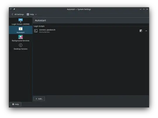

To run the script at startup, place the script (let's call it connect_speaker.sh) somewhere (I suggest ~/bin), make it executable (chmod +x ~/bin/connect_speaker.sh) then, in System settings:
  • Click on "Startup and Shutdown"
  • Click on "Autostart"
  • Click on "+ Add..."
  • Select "+ Add login script..."
  • Navigate to ~/bin
  • Select connect_speaker.sh
  • Click on "Open"
screenshot
