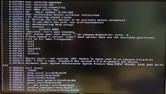

I am currently running Ubuntu 20.04 on my UEFI Bios PC in dual boot with Windows. Everything works fine. Since the support for Ubuntu 20.04 is almost at the end of its life, I wanted to replace it with 24.04. However, as soon as I try to boot from USB stick (UEFI mode), I get the following error, and the booting stops: Initramfs unpacking failed: invalid magic at start of compressed archive
After this error, no interaction with the PC is possible, and I have to press the reset button. To get more information, I removed the "quiet splash" options in the grub boot menu, which resulted in the output shown in the following screenshot:
Error in 24.04:
Screenshot of the error in 24.04
Since the installation was working quite well for Ubuntu 20.04, I downloaded all subsequent versions of Ubuntu to figure out when the error started, which is the case for Ubuntu 23.10. When I boot Ubuntu 23.10 from USB, I get the output as shown here:

As suggested by @Jags, a solution is to use mkusb for the generation of the USB boot device (it can be found at Launchpad PPA: https://launchpad.net/~mkusb/+archive/ubuntu/ppa). At the set up of the boot device with mkusb, take care to set it up in persistent mode, which probably uses a different GRUB setup and, thus, avoids the error.
I had this exact problem on a pc and it was making me angry. A friend suggested that my drive was bad and although I had never had issues with it before, I swapped out the drive and it ended up installing just fine after the drive swap.
I had the same issue.
The solution by @Jags (https://askubuntu.com/users/928088/jags) worked and I'll later explain which options I used and why (as well as how and why I believe this solution works).
I then tried the solution by @oldfred (https://askubuntu.com/users/126395/oldfred) - I updated the BIOS firmware - and it fixed the issue completely, so, now, I can install in UEFI mode cleanly out of the box, without the work-around by @Jags.
In case it helps someone, my motherboard is Intel DH77EB. A thread on the Intel support forum about how to update the BIOS firmware on this motherboard. Unfortunately, at this point, Intel have removed all info and downloads for this motherboard from their website, but it can all still be accessed via the Wayback Machine (https://web.archive.org/): the BIOS firmware update download page for this motherboard.
