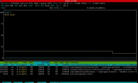

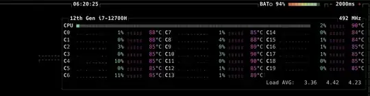

  • Top does not show significant CPU load. Even during normal system operation, when the overall CPU load is over 50%, it has almost no impact on interface responsiveness. btop
    nvtop

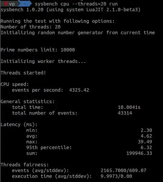

sysbench running at a time when the system was slow

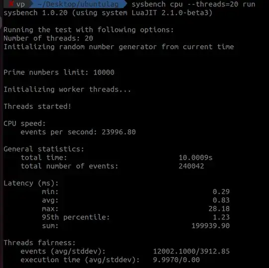

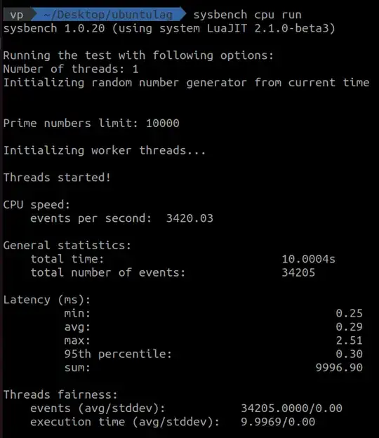

sysbench launched after reboot in Performance mode

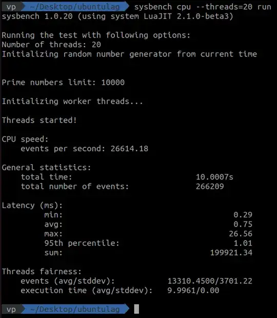

sysbench launched after reboot in Power Saver mode

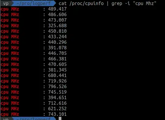

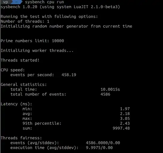

It is noteworthy that the sysbench shows a huge difference in the “events per second” indicator: 458.19 vs 2990.47 It's as if something is severely limiting the processor.

I was able to find out that this is a known problem and it is associated with lowering the processor frequency. Here are some links that may help you dive into the problem and try different solutions. I'm still in the process of researching.

I'm guessing that the original cause of the problem may be due to overheating of the processor. Now the usual operating temperature is about 90 degrees Celsius. enter image description here I've been using my laptop for 2 years now and haven't done any cleaning. The problem may be dust or thermal paste. I'm going to do a cleanup, but that's not what my answer is about.

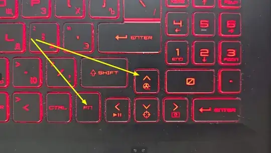

Some time ago I started using the Cooler Boost hotkey enter image description here This helps reduce the processor temperature by approximately 10 degrees.

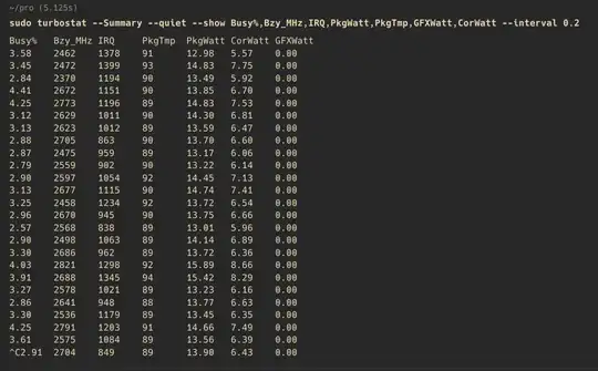

This time, when the computer switched to 400MHz mode, I pressed Cooler Boost hotkey and checked the turbostat.
It showed the normal, non-reduced frequency. The computer has returned to normal mode.
