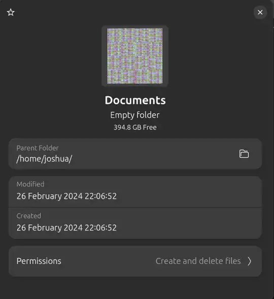

I'm running 23.10 and just noticed that if I right click a folder, file, or shortcut from file browser and select properties the icon looks like static. How do I fix these broken icons?
  • Graphics Card: AMD Radeon RX 7600 (RADV NAVI33)
  • Graphics Driver: radv
  • Driver Version: Mesa 24.1~git2402290600.3d38c9~oibaf~m (git-3d38c95 2024-02-29 mantic-oibaf-ppa)
lspci ; LIBGL_ALWAYS_SOFTWARE=1 nautilus

The issues I had were with the drivers from the oibaf PPA. Here's how I fixed it:
  1. Revert to stable drivers
Using the command suggested by the PPA maintainer sudo ppa-purge ppa:oibaf/graphics-drivers didn't work, nor did attempting to specify my distro with sudo ppa-purge -d mantic ppa:oibaf/graphics-drivers. I had to follow the instructions from https://forums.linuxmint.com/viewtopic.php?t=381601 which are (more or less) as follows:
sudo apt-add-repository --remove ppa:oibaf/graphics-drivers
sudo dpkg -P --force-depends libdrm-amdgpu1 libdrm-common libdrm-intel1 libdrm-nouveau2 libdrm-radeon1 libdrm2 libegl-mesa0 libgbm1 libgl1-mesa-dri libglapi-mesa libglx-mesa0 libxatracker2 mesa-va-drivers mesa-vdpau-drivers mesa-vulkan-drivers
sudo rm /var/lib/apt/lists/lock
sudo rm /var/cache/apt/archives/lock
sudo apt --fix-broken install
sudo apt autoremove
sudo apt autoclean
And reboot your computer.
