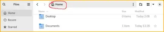

I found that I can enter a specific path by clicking the bar at the top, so maybe that was added after this question was asked?
However, this only seems to work when I've opened the app, not when I'm trying to save or open a file. That would be nice to have.
Screenshot of Nautilus Files window
