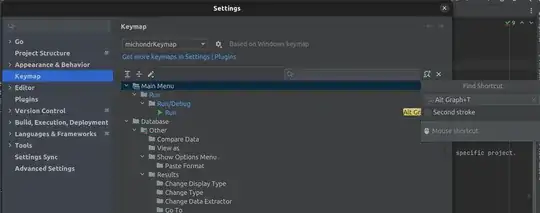

keyboard settings in GUI:
goland: (pressing alt-gr + t):
when focused on the search:

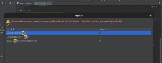

Alt-GR settings in goland registry:

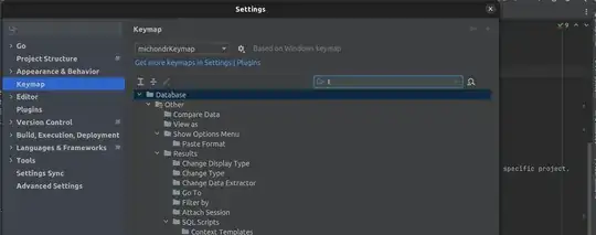

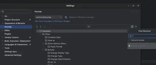

keyboard settings (also tried to have "alternative characters key" as right alt, still does not help (after logout and restart:
when focused on key search:
when focused on search:

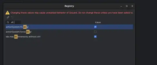

goland registry:
