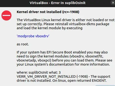

After upgrading the kernel from 6.2 to 6.5, i encountered an error from VirtualBox which is shown in the picture below about virtualbox-dkms missing.
I tried reinstalling the linux-headers-generic and virtualbox-dkms and reactivating it, even rebooted the system with the kernel v. 6.2 and still didn't work out.

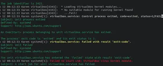

journalctl -xeu virtualbox.service
journalctl -xeu virtualbox.service (output)

It is a bug, VirtualBox 6 isn't compatible with the new kernel. You have to revert-back to the old kernel or install the VirtualBox 7 from oracle:
Stop the virtualbox service:
sudo systemctl stop virtualbox.service
then:
echo "deb [arch=amd64 signed-by=/usr/share/keyrings/oracle-virtualbox-2016.gpg] https://download.virtualbox.org/virtualbox/debian jammy contrib" |
sudo tee /etc/apt/sources.list.d/vbox.list
wget -O- https://www.virtualbox.org/download/oracle_vbox_2016.asc |
sudo gpg --yes --output /usr/share/keyrings/oracle-virtualbox-2016.gpg --dearmor
sudo apt-get update
sudo apt-get install virtualbox-7.0
Bug #2048956 : virtualbox-dkms 6.1.38-dfsg-3~ubuntu1.22.04.1: virtualbox kernel module failed to build
