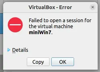

When I tried to start a new session of my virtual machine, I got an error saying: Failed to open a session for the virtual machine miniWin7.
failed_to_start_new_VM_session
