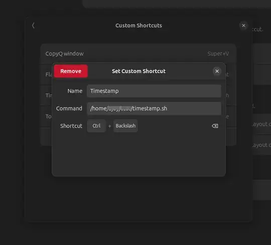

You can achieve this using a script file and xdotool.
  1. Install xdotool using this command:
    sudo apt install xdotool
  2. Create a script named timestamp.sh and add the following lines:
    #!/bin/bash
    Get the current timestamp
    timestamp=$(date +"%a, %B %d, %Y")
    Use xdotool to simulate typing the timestamp
    sleep 1 xdotool type --clearmodifiers "$timestamp"
  3. Now give the file the necessary permissions using this command:
    chmod +x timestamp.sh
  4. Configure the shortcut by going to SettingsKeyboardKeyboard ShortcutsCustom Shortcuts. Give the desired name for the shortcut in the Name field. In the Command field, use the command /path/to/the/file/timestamp.sh. Also, add the shortcut that you want to use (I used Ctrl+Backslash).
    custom-shortcuts
That's it. Now you can use this shortcut to print the timestamp anywhere.
