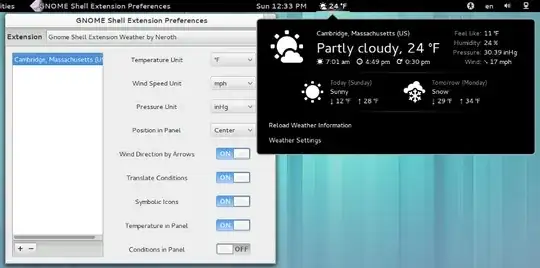

So to install this just move on here and click that switch-i like thing on the right to turn it on, and it will ask you do you want to install it. Just say yes. Add your cities and you have another awesome weather app for gnome!

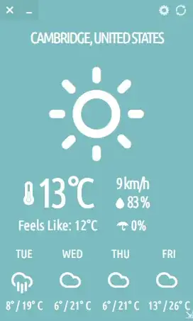

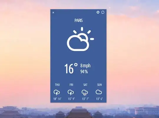

There's a fork of Stormcloud (with some new features) which works in Ubuntu 22.04+.
To install Typhoon, start terminal by Ctrl+Alt+t, then run the following commands one by one:
sudo add-apt-repository ppa:apandada1/typhoon
sudo apt-get update
sudo apt-get install typhoon
