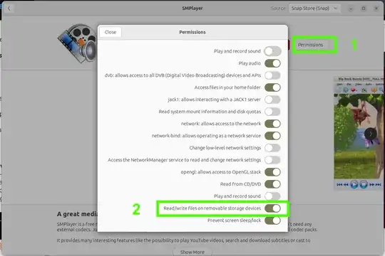

This is most likely due to the default security policy for Snap applications regarding connecting to the removable-media interface which is usually not granted by default ... You can inspect that for snap installed smplayer like so:

... and can be enabled with:
sudo snap connect smplayer:removable-media
... so it will report as such:

... and this can be disabled anytime with:
sudo snap disconnect smplayer:removable-media
Notice this can also be done from the UI of the snap-store AKA Software app like this:
