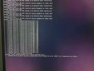

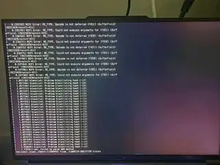

Each time I boot Ubuntu, this message shows up on my laptop screen below errors and failures, with my HDD making noise for several seconds. However, each time it does not stick boot. The word "hash" appears frequently in the error messages.
Some answers said that it may be caused by NVIDIA. The answer said that I should delete and uninstall something have to do with NVIDIA. But these errors and "clean message" still exists even if I have conducted his or her instructions.
Before that line
After that line, the font get extremely small

TLDR? Go to "Bottom line" ... Otherwise:
Clean ***/*** files, ***/*** blocks is not your problem ... It probably, almost certainly, happens on most computers at most boots and a simple:
sudo grep -E -- '---.*---|clean.*files.*blocks' /var/log/boot*
... will reveal it had happened multiple times on multiple boots, but is hidden with the splash screen so goes unnoticed most of the time ... That is until some other message that needs attention e.g. an actual warning/error is printed and then it's shown among other printed lines but it's not an error or even a warning in itself.
The warnings/errors that show in your screenshots are actually due to a failed communication between the Ubuntu's kernel and your computer's BIOS/UEFI firmware related to WMI and WDG ... In such miscommunication situation, those messages are most likely ambiguous, so shouldn't be taken for granted.
WMI(Windows Management Instrumentation) and WDG/WinDbg(Windows Debugger/Debugging) are both Microsoft Windows related technologies with the former being on the computer's firmware side and the latter being on the Windows OS side ... In short, your computer is solely designed for the Microsoft Windows OS ... And it's not just your computer, see this post and this post for example and it's more common than it appears these days.
Likewise, some sub technologies/devices on those platforms might be designed as well to be best handled by a proprietary driver designed for the Windows OS and is only made available for Windows ... In fact some CIRRUS LOGIC chips fall within this criteria like CS35L41 and the error you have is discussed here and here.
That said, the Ubuntu(Linux) kernel has ways and sub-systems that can translate, understand and mimic those technologies and it shouldn't be a big issue and most of the time wont affect functionality aside from the confusing error messages like the ones you see ... It might be worth noting though that in some cases, although a minority, the computer's functionality is hindered particularly things related to ACPI(Advanced Configuration and Power Interface).
It might be worth noting that those issues are reliant on either BIOS/UEFI support for the Linux kernel or Linux kernel's support for BIOS/UEFI or both ... So, upgrading your BIOS/UEFI firmware or your Ubuntu's OS kernel could very probably bring a fix with it.
Bottom line is if your system functions as expected, then you can ignore those warnings/errors related to WMI/WDG.
