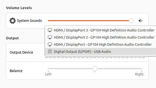

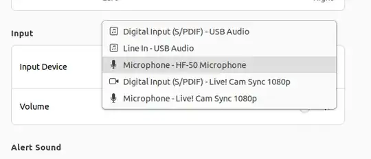

Sound management panel:
Any help will be appreciated!

The only thing I got to work for SPDIF is:
pacmd load-module module-alsa-sink sink_name="SPDIF-Fix" sink_properties=device.description="SPDIF-Fix" device=hw:Audio,2 control='PCM',1
for headphones change to device 1 instead.
