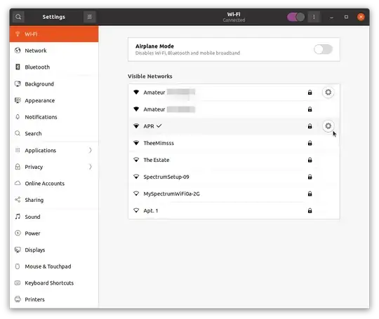

I tried following the steps in this previous question here on Ask Ubuntu on forcing to 5GHZ, but I have none of those options that are shown in the examples, such as choosing the BAND. Here is what I can see, there are really no options.
top level of Wi-Fi Settings
Detail on the Network, shows both frequencies, but no option to choose them

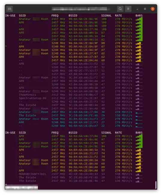

Using the information from @Jeremy31 and @Chili555, I was able to find a simpler command.
nmcli -f in-use,ssid,freq,bssid,signal,rate,bars dev wifi
This brought back a simple list of all wireless access points with their frequencies, and the needed BSSID. Armed with this info, in the second tab of the dialog box IDENTITY when you click on the details of the network:
you can enter the BSSID and lock it to that access point. I think this solves my issues.
