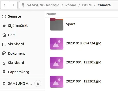

  • Copying files via USB from my android phone to the PC with Ubuntu is easy, connect the phone directly to the PC via USB. As already mentioned by yehtetmaungmaung, in the phone you must allow it (in a popup window).
    I do this often in order to copy photos to the PC, and I use two windows of the file browser 'Files' alias nautilus for this purpose, one viewing the source directory in the phone and one viewing the target directory in the PC).

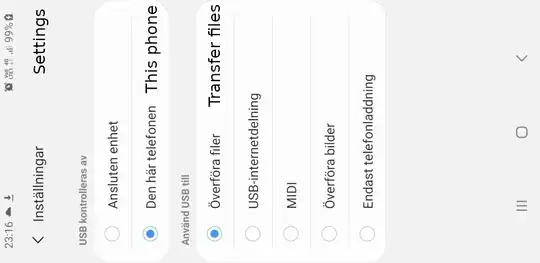

  • I tested some settings in my android phone (in the pulldown menu when connected to my computer). I let
    • the phone control USB
    • use USB to transfer files

  • In the current Ubuntu versions (2023-2024), for example 22.04.3 LTS, when the phone is connected via USB (and mounted automatically), I find the path to it using this command,
    find /run/user/*/gvfs -maxdepth 1 -name 'mtp:*'

I had the same problem,no popup when connecting my tablet to my pc in xubuntu. It was a good cable,the one I also use to transfer files to my e-reader and that works. What I found is when I connected my tablet to the pc there is message in the pull down menu from the top on my tablet with 'tablet loading' (in dutch - tablet opladen) and very small below it: more options. When I clicked that I found a page with usb options what is allowed. Just loading only or also transferring files. I choose the last one and it all worked fine.

When you connect the devices a phone icon appears in the Ubuntu Dock (similar to that of a connected USB drive) and a pop up window opens on the Android device with an option to allow data transfer. Select that and the Ubuntu file manager treats the phone like an external drive. That's it.
