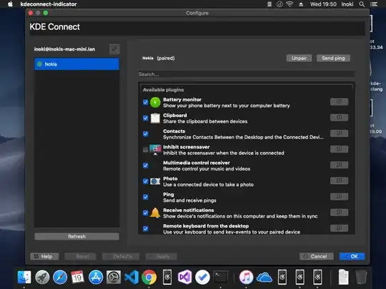

Using KDE Connect:
KDE Connect lets you connect all the devices within the same wifi network. Install the application on your mobile device (whether it is Android or iOS) and install the Linux software from their Download page.
It has many features like Remote control, send clipboard, presentation mode, Run command, file transfer, etc. I have used this application and it shares my copied text from Ubuntu to my Android phone instantly when I copy on the system itself. On Android, you have to share the copied text, select the KDE Connect app, and then select your device to get that text.
KDE Connect window

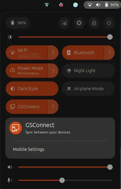

Using GSConnect:
It is a GNOME extension that implements the KDE Connect protocol where you don't have to install the software to achieve the same. You still have to install the KDE Connect application on your mobile device. You will even be able to access several features within the control panel. I am using this extension, which provides all the features provided by KDE Connect.
GSConnect on control panel

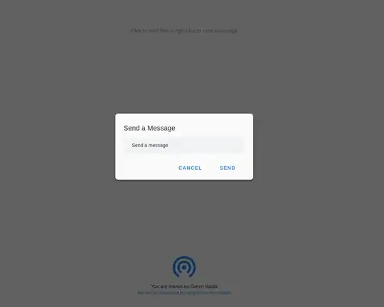

Several websites will transfer files within the same network without any internet. One such website is Snapdrop which will allow you to share your text and send files. You don't have to install and configure any application on any device by this method.
snapdrop website
