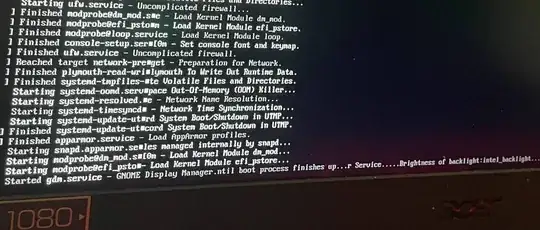

I just faced with this issue and after trying different options, I finally could solve the issue by doing the following steps:
  • While being stuck in the page you shared the image, press Ctrl+Alt+F3 to get into another tty.
  • Provide user/pass and login to your account
  • Run sudo apt install --reinstall ubuntu-desktop
  • To verify the solution, run startx. If successful, you can restart the system and expect the gdm can work properly.
