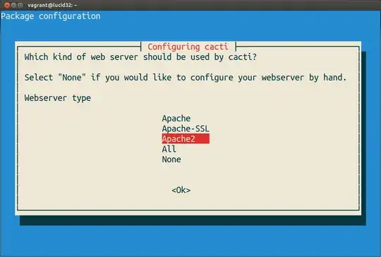

However, one thing that catches people is that it gives you a choice of which HTTP server you want to have it run under.
Unless you have good reason to do otherwise, select "Apache2" and hit enter.

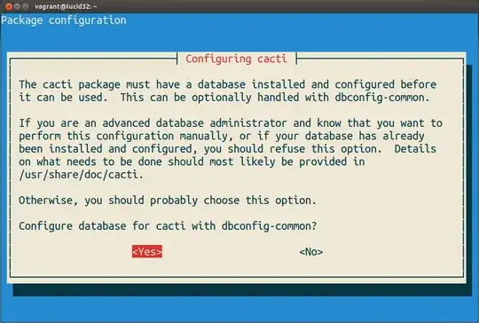

When it asks you if you want to have the database configured with dbconfig-common, select yes.

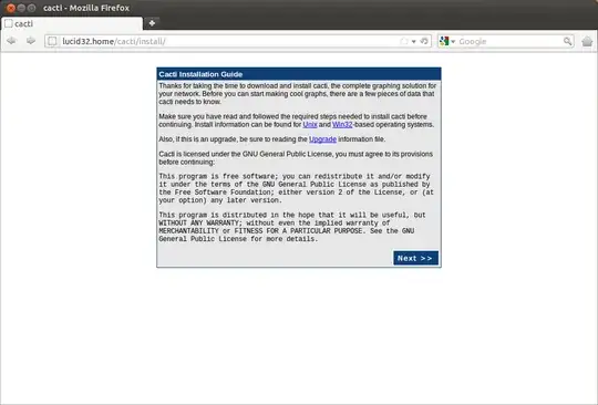

Click next if you agree to the license.

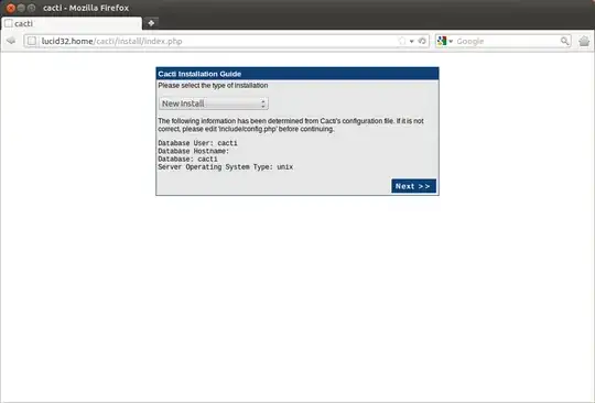

Now you need to tell it what kind of installation - we're assuming you're doing a new install here, so just click "Next".

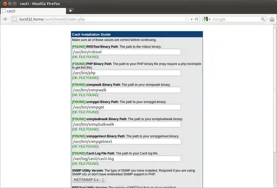

Now here is the important part.
It will try and find all the various tools it needs - by default, they should be all green, but if it isn't, you'll need to do some digging to find where that tool is.
Click next.

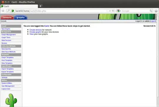

Now you're at the login screen. The default username is admin, and the default password is admin as well.
Now it will have a forced password change. Change your password to whatever you want it to be.
Hit next after that, and you're in!
Have fun with Cacti!
