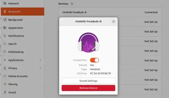

Then the device is paired and can be activated (connected), a nice dialog to open the sound settings shows up etc.
It is the same dialog as when single-clicking the device in the Bluetooth settings:
The Device ID reads: 9C:56:36:F8:86:7E.
