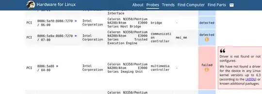

I may have reached the wrong conclusion, but is it safe to assume that the current multi-media card does not work with the current Linux kernel? When researching the audio card I stumbled upon this https://www.intel.com/content/www/us/en/download/18857/audio-firmware-and-user-guide-for-the-intel-atom-processor-e3900-series-intel-celeron-processor-n3350-and-intel-pentium-processor-n4200-on-yocto-project.html
I do not have enough Linux understanding to install this firmware or edit and burn a bios or the create a custom Linux kernel image. I was wondering if there is anything that i ma be missing, I have tried all the solutions involved with Alsa, Pulseaudio and Pipewire, and editing Modprobe and other related files with absolutely no change. Is it safe to assume that the problem is deeper than software incompatibility?
I have also tried reinstalling firmware-sof-signed and ubuntu-drivers-common, which just resulted in no updates happening because the firmware was up to date. Also note that I have updated the kernel using Mainline Kernels package to the newest Linux kernel. This has not helped.
I've been doing some research on ALSA project, IT seems that the card really isn't built into ALSA according to this page and the PCI vendor device Code doesn't seem to have been added as a driver to ALSA. Further research shows that it was never added to the kernel for some reason. I will research further solutions.
If anyone knows how to add firmware to a kernel or has good resources on it please notify me.
