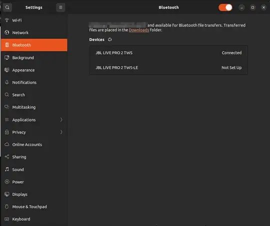

First turn off the laptop bluetooth. Then you have to do a quick click followed by a 5 second hold on the right earbud. This will make the earbuds enter pairing mode.
Then you turn on the bluetooth. In my case pairing with the "JBL LIVE PRO 2 TWS-LE" didn“t work. I had to pair with the earbud when it showed up as "JBL LIVE PRO 2 TWS".
I had to repeat this proccess a few times until it showed up on the list as "JBL LIVE PRO 2 TWS".

  1. Turn off the laptop bluetooth under Settings -> Bluetooth.
  2. To enter pairing mode, do a quick click followed by a 5 second hold on the right earbud. You will hear the word "pairing" in the earbud when it has entered pairing mode.
  3. Turn on the bluetooth from Settings -> Bluetooth.
  4. Open a terminal and run bluetoothctl then from within the bluetoothctl shell run scan on.
  5. Switch back to the settings page Settings -> Bluetooth and watch for your device to show up.
$ bluetoothctl
Waiting to connect to bluetoothd...[bluetooth]# Agent registered
[bluetooth]# scan on
[bluetooth]# <- lots of devices might show up depending on how many bluetooth devices are nearby
[bluetooth]# [NEW] Device 28:6D:40:A9:BA:CD JBL LIVE PRO 2 TWS
[CHG] Device 28:6D:40:A9:BA:CD Connected: yes
