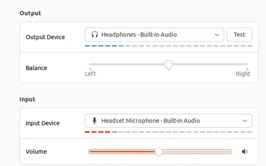

After some recent updates my computer started to get all Output Audio to my input audio device.
Clarification: All computer sounds (videos, voices, musics) are captured by the "input audio" I can hear it from my headset but i join any meting everybody can hear it too.
I tried 2 headsets and using the Computer audio, in all cases the output goes to the input audio.
As you can see on the image the input audio is capturing a music that is playing on my headphone. OBS: on this case my mic is muted analogically.
I tried many solutions that I found around, but any of seems to work. enter image description here

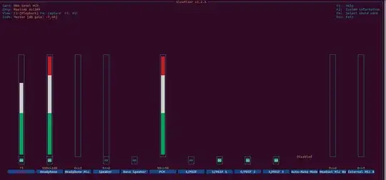

Solution:
On alsa mixer the 1st tab represent the sound Output, I just had to set the "Headphone Mic" to zero.
