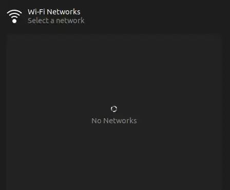

Edit2: As I'm writing this, wifi's stopped showing up again, enter image description here
"nmcli device wifi list":
IN-USE  BSSID  SSID  MODE  CHAN  RATE  SIGNAL  BARS  SECURITY
"sudo dmesg | grep wlp": doesn't result in anything.
