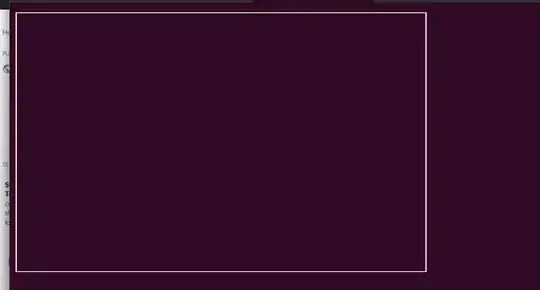

so basically at the installation menu I can skip the drivers but right now when I select Driver Options in that menu, I get a blank bash:
blank bash
