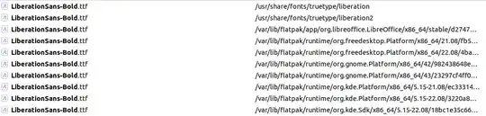

I would like to have HelveticaLTStd-Bold substituted with LiberationSans-Bold font. It is already installed in many places:
but DejaVu Sans is chosen instead:

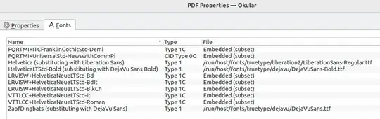

I didn't notice a different font name in that configuration file. I edited it, and it solves my problem with Document Viewer. Unfortunately, Okular (installed with Flatpak) still uses DejaVu Sans and produces this misformed kerning:
Here are the fonts used in this document:
