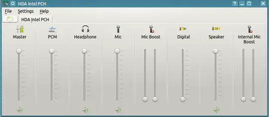

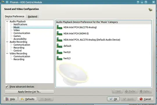

Never mind, finally my problem is assumed solved.
I updated ALSA driver with this driver update script.
And then installed PulseAudio Equalizer as explained on this thread.
And now, the Audio Setup does showed ALC270 soundcard.
The sound quality is almost as good as in Win7.
Audio Setup
Mixer
