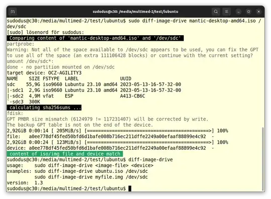

Screenshots using version 1.3 of the shellscript:

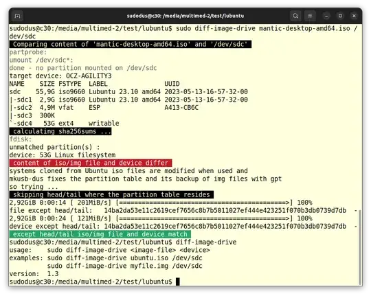

The color high-lighting is there also in the original version, but checking when skipping head/tail is new. This helps checking when a drive cloned from an Ubuntu iso file has been used (so that a 'writable' partition was created).
Checking directly after cloning.
Checking after the drive was booted into.
