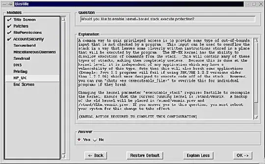

One Zero
  • 27,761
Make use of the Bastille Linux project.
It provides an interactive tool to perform additional security hardening measures to increase the over-all security, and decrease the susceptibility of compromise for your Ubuntu system (from Bastille Linux).
It offers an assessment and reporting functionality, so that it can tell you what parts of the system aren't locked down. It examines the system in a read-only fashion, reporting on the status of each of its hardening items. For example, Bastille might check whether the DNS server is locked in a chroot prison, whether telnet is turned off, or even if passwords are required to be a good length. You can take a look at a Web-only demo of this through this link (more info).
You can have preview of the Web (only) demo here.
