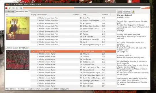

The solution should be the Infobar plugin - but in my case it doesn't look properly. It should look like this (from the author's site) deadbeef whith infobar as should be
but instead it looks like this, with a large empty space above the tabs:
deadbeef whith infobar error

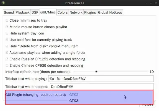

In v. 0.5.6 the Filebrowser and the gtk2 version of Infobar have the same incompatibility. But there is a gtk3 version of Infobar, and Deadbeef v. 0.5.6 has a gtk2-gtk3 GUI switch. enter image description here Installing Infobar gtk3 and the File-browser, which is gtk 2, will result in using the two plugins alternatively: in the gtk2 GUI of Deadbeef only the file-browser will be visible, in the gtk3 GUI, only the Infobar. Switching between GUIs will switch between plugins too.

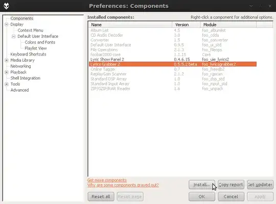

When lyrics are not found by Deadbeef/Infobar, use Foobar in wine and install the lyrics grabber addon. enter image description here enter image description here
But usually would not need that (the difference with Foobar is that it embeds the lyrics into the file: Deadbeef displays them from internet)
