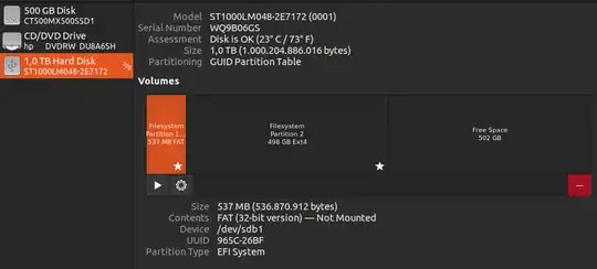

The current situation is: hdd overview Here the only mounted partition is sdb1 on /boot/efi (In the picture I manually unmounted it while doing some tests).

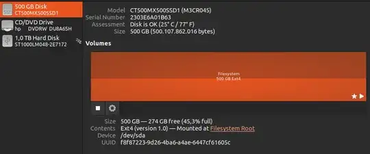

ssd overview
