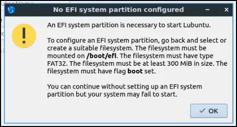

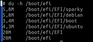

You can use something like VirtualBox to install all the OS you want into one VM, sharing the /boot/efi and see what comes out.
Lubuntu for example recomends 300MB. It used much less, but I guess it plans to leave there future kernels.
A totally fresh installation of Sparky [ sparkylinux-6.7-x86_64-minimalgui ] and lubuntu [ lubuntu-22.04.2-desktop-amd64 ] gives this usage.
