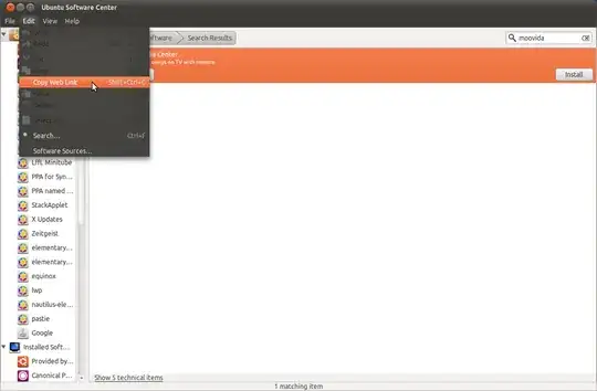

To create an APT link, open up Ubuntu Software Center ( Applications -> Ubuntu Software Center ), search for and find a package:
alt text
Now click Edit -> Copy Web Link or hit Shift+Ctrl+C:
alt text
You should now have an APT link in your clipboard, like this: http://apt.ubuntu.com/p/moovida

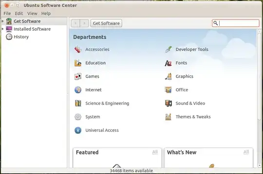

You can find the name of a package through the Ubuntu Software Center:
alt text
Once launched type the name of the software you wish to find the package name for in the top right search box.

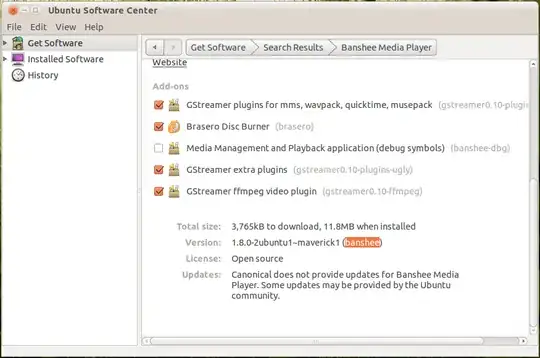

Once you find the software you are looking for select "More Info"
alt text
At the bottom of the additional information page you'll find Version information which contains, in parentheses, the name of the package
alt text
This is the package name you'll want to use in either apt-get commands or in APTURL links. Also - as demonstrated in the above picture - the package names of available add-ons are listed in parentheses next to each respective add-on.
