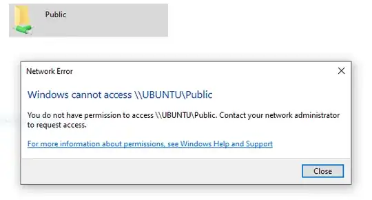

This is the error that I'm getting on Windows.

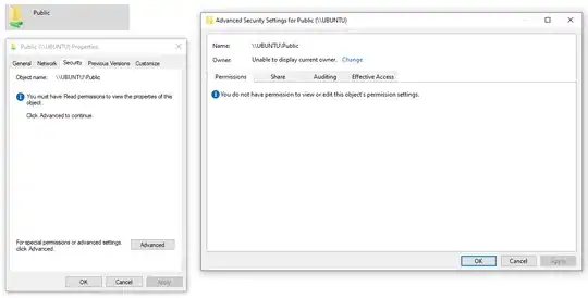

Windows does not have read permission.

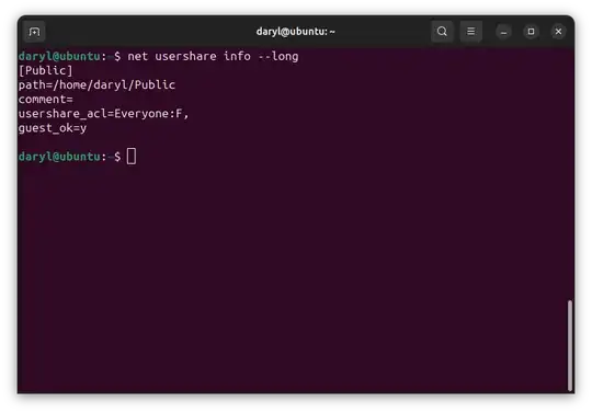

Here is net usershare info.
