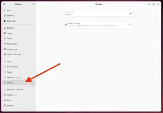

  2. Click the "Sharing" option on the left: Sharing in Gnome is too hard

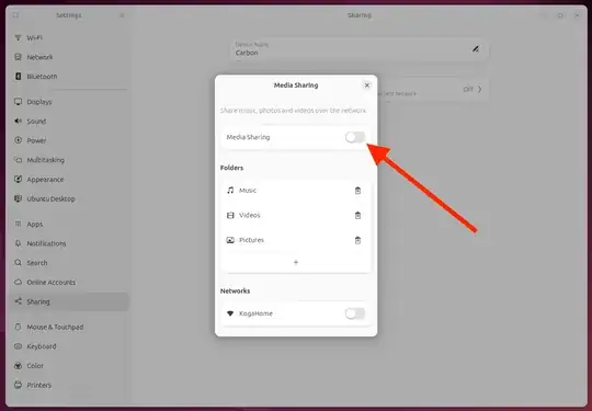

  3. Click the "Media Sharing" item to open a small modal: Slide that Toggle
  4. Click the "Media Sharing" toggle to activate it.

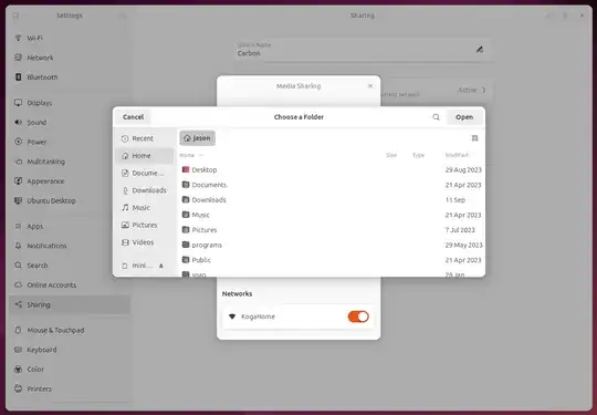

  5. If you do not want to share your Music, Videos, or Photos directories, click the trash can to remove permissions. If you would like to share a specific directory, click the little plus and choose the location you'd like to share: Add any Directory
