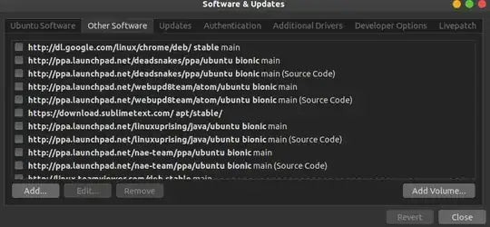

So I was struggling with this probbem from 2 days and now I have solved it....
First run this command
sudo software-properties-gtk
then check all box like this:
do this what mentioned in this pic
after that go to other software tab and untick all boxes like this:
untick all boxes in other tab
and now click close button -> after that a window will be opened and click reload, I hope this will work you also....
Try this procedure.
