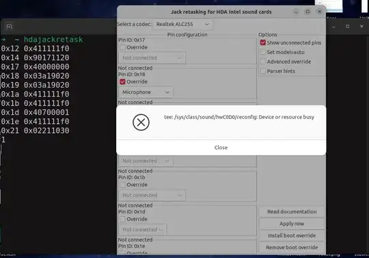

My Acer Aspire 3 laptop has a combo jack (both headphones and mic) so when i plug in my headphones (tried multiple headphones razer+other brands) only the headphones work, the mic does not.
i show similar post here My microphone is not working but when i try to reset jack it just gives error. see screenshot enter image description here

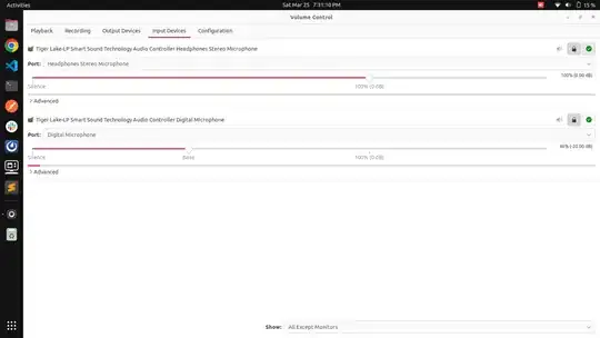

also after shutting down system applying settings hdajackretask pavucontrol shows following input devices but still no sound using headphone mic. enter image description here
I suspect i need to do other changes or some other issue with my settings also i am using ubuntu 22.04 so is there any other changes i need to make or some other pins apply based on my sound card ?

First determine what handles your audio device - there are multiple ways - ALSA, Pulseaudio, Jack, Pipewire even if you using tools for any of those and those are working it might mislead you - as all those audio framework can work directly with hardware or sit on top of another framework installed in parallel. To determine issue those two commands:
systemctl  | egrep  'alsa|pulse|jack|pipewire'
sudo ps aux  | egrep  'alsa|pulse|jack|pipewire'
Also it would be probably better to stop audio system at all using systemctl command, then do the modificaton and start audio system again. If you want this change to be permament you can use 'Boot override' option of the tool.
Regarding exact error you are getting you can try: lsof /sys/class/sound/hwC0D0/reconfig to determine what occupies the device. Also check if your groups output contains audio group
