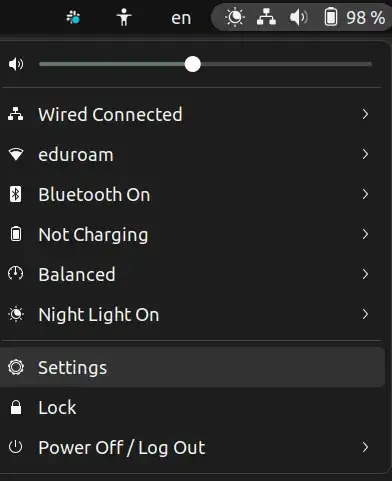

I am having little issue with battery or UI. I am having dual boot Windows/Ubuntu on my HP Elitebook. On UI it shows me that battery isn't charging but its on 98% for 5 hours now.

Does anybody know how can I fix this? Thank you!

This is in fact normal behaviour for most laptops.
Batteries deteriorate if they are unnecessarily charged. There’s little point charging from 98 to 100%, but will cause better wear.
Clearly the power supply is working as your battery isn’t discharging despite using for several hours.
My Asus laptop typically doesn’t show as charging when I plug it in unless the battery is below about 95%.
You could try discharging the battery for a bit - say to below 90% - then plug it in and check it charges.
I think this behaviour is driven by the bios, not the os.

I have the same issue. I did following things to resolve this.
  • unplug power adapter for 5 minutes.
  • press and hold power button for 30 seconds
  • plug power adapter and start laptop.
