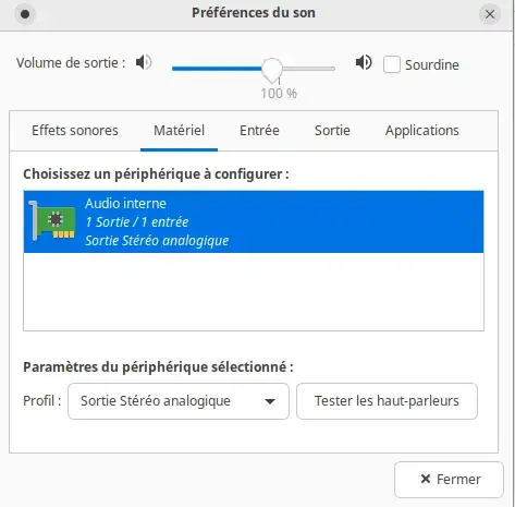

With kernel 5.19.0-35, HDMI output is not found:
$ uname -a
    xxx 5.19.0-35-generic #36~22.04.1-Ubuntu SMP PREEMPT_DYNAMIC Fri Feb 17 15:17:25 UTC 2 x86_64 x86_64 x86_64 GNU/Linux
    $ cat /proc/asound/cards
     0 [PCH            ]: HDA-Intel - HDA Intel PCH
                          HDA Intel PCH at 0xa0340000 irq 127
$ inxi -Fam Audio: Device-1: Intel Comet Lake PCH-V cAVS vendor: Micro-Star MSI driver: snd_hda_intel v: kernel alternate: snd_sof_pci_intel_cnl bus-ID: 00:1f.3 chip-ID: 8086:a3f0 class-ID: 0403 Device-2: AMD Navi 10 HDMI Audio driver: snd_hda_intel v: kernel pcie: gen: 4 speed: 16 GT/s lanes: 16 bus-ID: 03:00.1 chip-ID: 1002:ab38 class-ID: 0403 Sound Server-1: ALSA v: k5.19.0-35-generic running: yes Sound Server-2: PulseAudio v: 15.99.1 running: yes Sound Server-3: PipeWire v: 0.3.48 running: yes
$ aplay -l **** Liste des périphériques matériels PLAYBACK **** carte 0 : PCH [HDA Intel PCH], périphérique 0 : ALC897 Analog [ALC897 Analog] Sous-périphériques : 1/1 Sous-périphérique #0 : subdevice #0
$ lspci | grep -i audio 00:1f.3 Audio device: Intel Corporation Comet Lake PCH-V cAVS 03:00.1 Audio device: Advanced Micro Devices, Inc. [AMD/ATI] Navi 10 HDMI Audio
