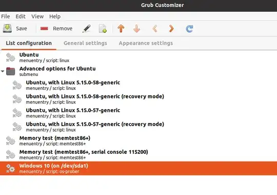

Due to GRUB inferring some boot sector as containing Windows 10, then my GRUB window shows Ubuntu and Windows (on /dev/sda1). See earlier discussion:

And the Entry editor for that entry looks like
insmod part_msdos
insmod fat
set root='hd0,msdos1'
if [ x$feature_platform_search_hint = xy ]; then
  search --no-floppy --fs-uuid --set=root --hint-bios=hd0,msdos1 --hint-efi=hd0,msdos1 --hint-baremetal=ahci0,msdos1  11FC-F339
else
  search --no-floppy --fs-uuid --set=root 11FC-F339
fi
parttool ${root} hidden-
drivemap -s (hd0) ${root}
chainloader +1
