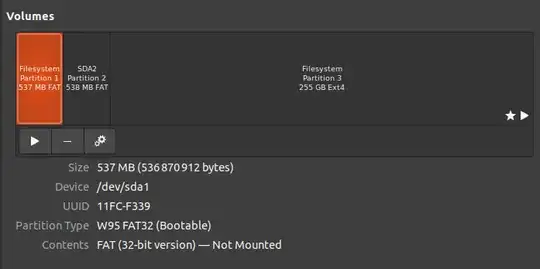

I installed Windows 10 on a separate disc, while my other (original) disc had Ubuntu 20.04. I don't recall, whether my original Ubuntu disc (shown in picture) already had 3 rather than 2 partitions, but now it shows:
Where the highlighted partition seems to report as "Windows 10" in GRUB.
Is this something added by installing Windows 10 on a second SSD? Or what is it? Can I delete it?

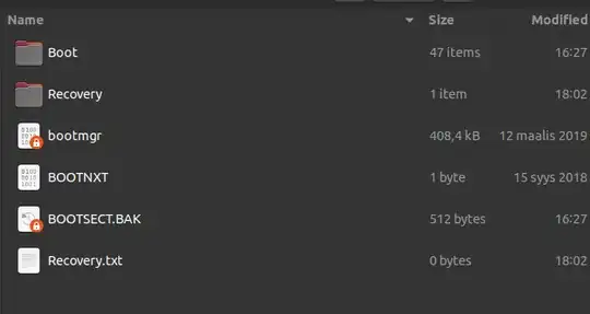

Contents look like:

That is the recovery partition created by windows 10 during installation. When you're creating new partition on an MBR disk, Windows will create a system reserved partition, and if it is a GPT disk, then Windows will create a recovery partition and an EFI system partition without a drive letter. The recovery partition on Windows 10 consumes about 450MB which would fit in that 537MB partition you have there. It is safe to delete if you don't care about recovering your Windows installation and want to free up some space.
This is how to delete the recovery partition in Windows. Use diskpart to remove it as shown in the link. You could also use disks in Ubuntu, which would accomplish the same thing.
