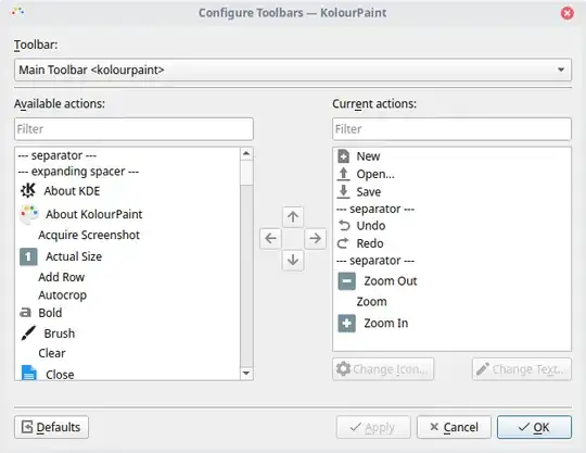

When you run kolourpaint from terminal, you can see that it's looking for 3 icon themes - breeze-icon-theme, elementary-icon-theme or gnome-icon-theme. I think that you have to set one of them in appearance menu, run kolourpaint and see if it works. If that does not work, you can set each the icons manually in Settings->Configure toolbars configure toolbar menu
